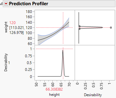

I followed the steps above using the Big Class data table. The weight is in the Y role and I added height and height^2 terms to the model. I defined the desirability function to match a target of Y = 120. Here is the result:
The inverse prediction is 66.3 inches.
