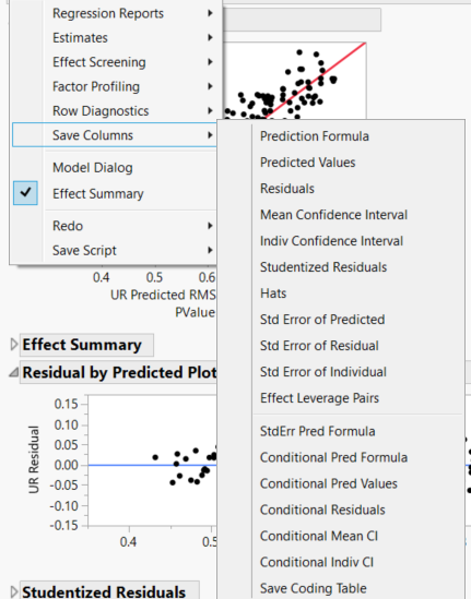

Why is the Save Columns > Indiv Confidence Interval Formula option not available in the Fit Least Squares report?
I am analyzing data with the fit least squares platform using the REML method and I do not see the option for Save Columns > Individual Confidence Interval Formula. The option to save the individual confidence intervals (without the formula) is available, but I need the formula. Is there a settings option that I need to change to enable this save option?

@jmessamer ,
This can be done with a script.  Below are two examples. You should post which version of JMP you aer using.
