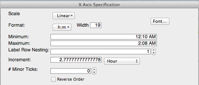

How do you control the Graph Builder Axis when zooming
When using the magnifier on a trend plot in graph builder, the x-axis settings are automatically changed. Is it possible to fix the axis tick increments (e.g. per hour or per day) and the corresponding grid lines, also when zooming in or out?

Hello, elie.maricau,
Personally is one of the details I like the most about JMP, the adaptive zooming axis.
In my experience you can fix the units, but not the "adaptive zoom". In a Column [Numeric, continuous], if you just do:
9416_Screen Shot 2015-08-05 at 1.14.02 PM.png9416_Screen Shot 2015-08-05 at 1.14.02 PM.png

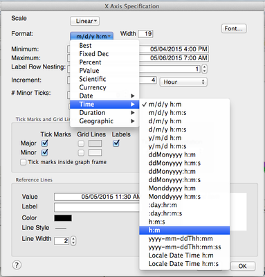

And then select an increment for "Y" like:
9417_Screen Shot 2015-08-05 at 1.14.36 PM.png9417_Screen Shot 2015-08-05 at 1.14.36 PM.png

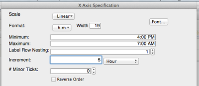

As soon as you move the axis the "Increment" adapts:
9418_Screen Shot 2015-08-05 at 1.19.28 PM.png9418_Screen Shot 2015-08-05 at 1.19.28 PM.png
It will show the same units, but t will adapt.

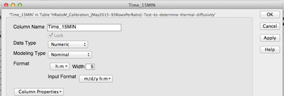

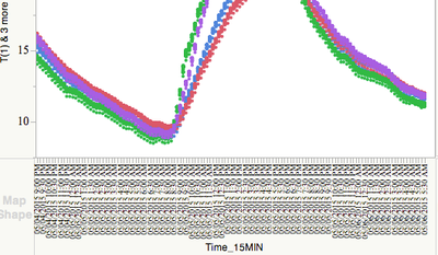

What I have done way to keep units fixed, is changing the Column type to "Numeric, Nominal". Then change the Format to something simple, like hours.
9419_Screen Shot 2015-08-05 at 1.25.11 PM.png9419_Screen Shot 2015-08-05 at 1.25.11 PM.png
This has worked for me. It keeps the ticks fixed.
9420_Screen Shot 2015-08-05 at 1.27.06 PM.png9420_Screen Shot 2015-08-05 at 1.27.06 PM.png9421_Screen Shot 2015-08-05 at 1.27.33 PM.png9421_Screen Shot 2015-08-05 at 1.27.33 PM.png
Hope it helps.
