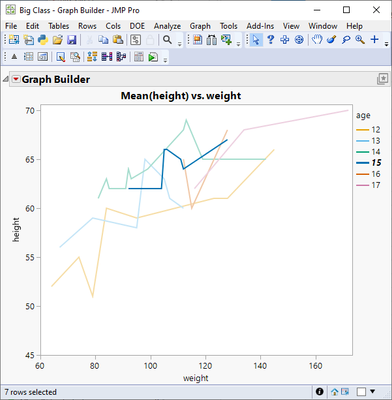

Does anyone have any ideas on how to create interactive reports?
In the report, I want to include graphs with multiple lines in each graph. On the left side of the window, I would like to have a list of the lines. When I click on a line from the list, I want the selected line in the graph to be more prominent, while the remaining lines are faded out.

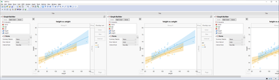

Re: interactive plots
I have this output when i run the above script . Its not the same as you
