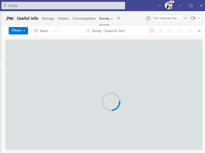

At the moment, when I want to share an interactive Jmp file via Teams or Sharepoint, my colleagues just see:
... and think that there is an issue with Jmp - or an issue with my Jmp file.
For them, it's hard to find out that actually it's a Teams / Sharepoint  issue with the interactive JavaScript code.
@John_Powell_JMP , for a future version of Jmp, would it be possible to slightly change the code of the interactive HTML?
Instead of starting right-away with the start animation,  the HTML code could check if Java Code can be executed and if not: show a warning that it's actually the browser or the site which prevents the page to be loaded correctly. Then it could show a suggestion to download the file and open it from the hard drive.
