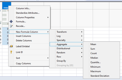

Select your grouping column (ID)
Then select the column you wish to perform the calculation on and pick Standard Deviation (note the Grouping by id)
-Jarmo
-Jarmo

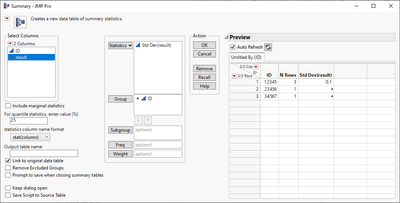

Create summary table

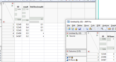

After you have the summary table, you can click on the stddev column and hold mouse down for some time. This allows you to "pick" the column and drop it to your original table

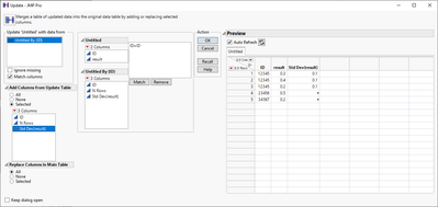

You could also have used Update with the summary table

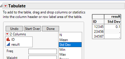

You can create similar table using Tabulate (note that id is nominal)
Then from red triangle, make into data table
you can then use Update (or join) to get the results back to your table.
