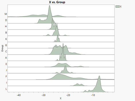

I have a dataset of X values for 12 distinct groups, see below their histogram.

I initially thaught logistic regression was the best approach, at least for 1) but for 2) I'm not sure. In particular for groups with a very narrow distribution like K for instance.

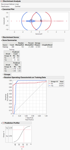

For ANN, I mean that when using X to predict the group, I have less Missclassified results than with LDA. This because LDA just gives a similar model that with logit, not allowing for a non-linear model (see profilers differences in attached images in an example for Group K).
As you can see the profilers for the ANN model is close to the distribution of Group K. My suggestion of fitting a distribution may not be relevant. It’s just that when I tried to fit a normal distribution model to group K for instance, I was able to save the model formula as a new column and use that as an indicator column for any new entry to evaluate the probability of this new entry of belonging to group K.

All said: Looking at your plot at the top, if you choose an x value, say -30 and draw a line straight up. You can see the percentage of area under the curve to the left of -30 for group M is about 50%. For group D it is about 20%, etc.   Is that the sorta thing you were thinking  when you said “fit a distribution model to a group (Normal or other) and use the model formula as a prediction formula?”
