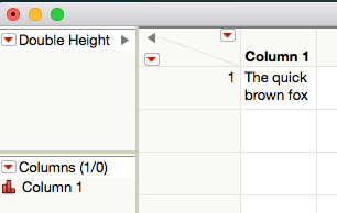

ian_jmp
Level X
Re: how to create 2 text lines in one table cell
Increase the cell height by dragging:
