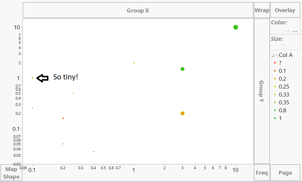

Untitled.pngIn using Graph Builder, I have a column that controls the marker "size", however they are all smaller than I'd like. Is there a way to change the size scale so that they all get larger by the same factor? Interactive mode is what I'm using, though scripting is fine too.

You can right click on the Size column (Col A) in the legend and select Marker Size.

This works, in my case I had to set the marker size to a custom size way larger than XXXL.
