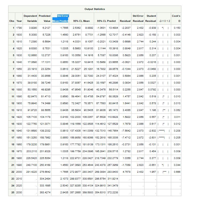

how to add Std Error Mean Predict column in our data sheet in JMP
hi all
i am doing my project and for my report i need to have the  Std Error Mean Predict column in my data sheet for all dependent variables. the picture below is the out put using SAS. i need to have the highlighted column added to my data sheet in JMP. is there any way to do that with out coding?

im using JMP pro. i want to calculate interval estimate when a particulat independent variable is known. and for that i need to have MSE for that particular independent variable.

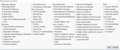

Re: how to add Std Error Mean Predict column in our data sheet in JMP
See the image below.  These are all of the options you can choose to save or add to your data table for a given report in Fit Model.
To get this menu hold your Alt key down and click the red hot spot by your Response in the upper left corner of the Fit Model report.
You can also set up your preferences to output any of the columns for every analysis that you do.
