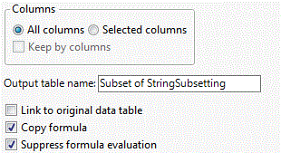

When you use
     Tables==>Subset
you can select the option to Link to Original data table
Jim

You could open the source property of your non-linked table, insert "link to original data table(1)" and rerun the script, but any edits before the table was linked will not be updated in the original table.
Example:
<< Subset(
link to original data table(1), // insert this line to the source script and run
Selected Rows( 0 ),
