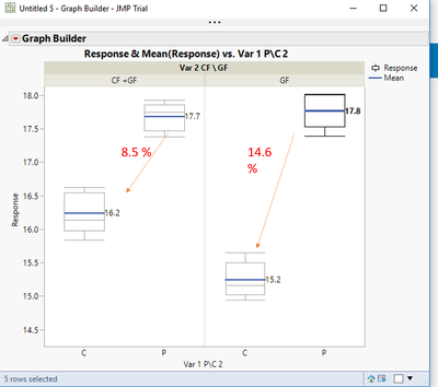

I built a graph with 1 response and two variations (X axis and warp) .
You can see it here
but, I would like to add a the percentage difference, as you can see in the next  photo- I made by PP
does anyone have a recommendation what is the best way to do this?

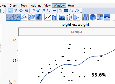

Re: how to add Percentage difference on graph
You can add the annotations by using the Objects available under the Tool Bar
Or you can use JSL and the "<< Add Graphics Script" to add the annotation programmatically
Jim
TalDamri
Level III
Thanks!
add it is possible to add a custom calculation automatically ?
txnelson
Yes.
Here is an example taken right from the Scripting Index for "<< Add Graphics Script".  It uses the Bivariate platform, but << Add Graphics Script is also supported for the Graph Builder
