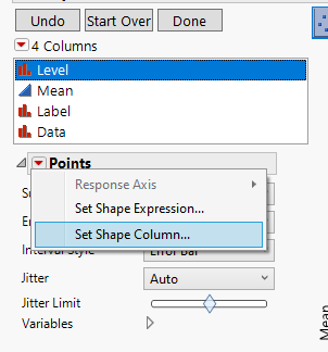

see question above

Right click on the connecting letters report, then select Make Into Data Table
In the new table, select the columns that have letters in them, then Table...Stack, stacking those columns
Hide and Exclude (or delete) and rows where the letter is blank

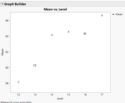

Make your graph
in the Red Triangle for Points, select Set Shape Column, and Select the column with the letters in it.
Output:
