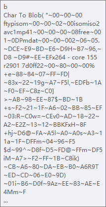

How can merge such binaries with JSL?
If I want to use JMP for something other than statistics: For example, I downloaded several video clips from the Internet, got binaries, and how to combine these binaries with JSL and save them as one video file. For example, this video is formatted as mp4 Thanks Experts!
rr = "";
rs = "";
For( j = 1, j <= N Row( dt ), j++,
	u = dt[j, "url"];
	request = New HTTP Request( URL( u ), Method( "Get" ) );
	rs = request << send;
	 rr = rr || rs ; //??
rr << Save video( "c:\3\test.mp4", "mp4" );  //??

Thank Craige! Yes, I still need to use JSL to analyze and get the real download address of the video. But Istill can't use JSL combined with ffmpeg to directly merge different videos in memory and save them to hard disk after merging.
