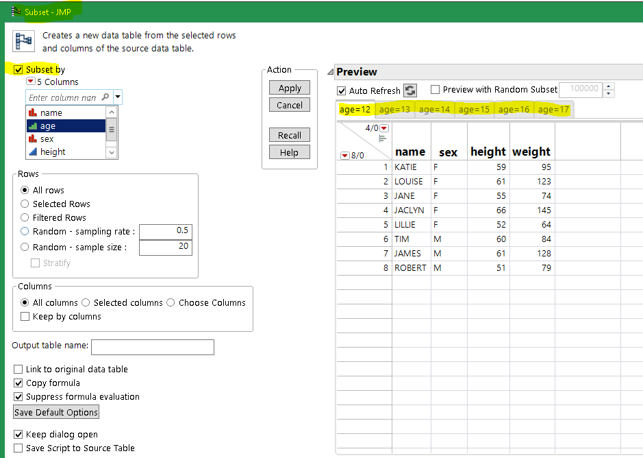

If you want a separate table for every unique value
tables->subset menu. Multiple tables are opened (see the tabs in this JMP 17 preview)tables->subset menu. Multiple tables are opened (see the tabs in this JMP 17 preview)
That could be a lot of tables opened at once. Usually you don't want to do that; most of the JMP platforms feature a by variable that will run the platform against each by-group. If you do need separate tables, grab the source script for your JSL from one of the subset tables; that script returns a list of the tables it opens. You might also want Keep by columns checked.
