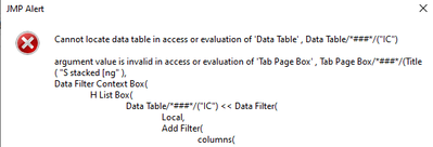

However, in contrast to the discovery talk, my dashboards are based on different data tables, and not a single data table.
I have all data tables and dashboards open, and run the above script to combine all dashboards into one multi-tabbed dashboard. This gives the following error message:
It looks like it is not able to extract the local data filters from my dashboards. Any suggestion as to how I can change the generic script to be able to combine all open dashboards?

UPDATE:
The error message above has nothing to do with the data source being multiple tables. On the other hand, if the name of one of the data tables contains a hyphen (-), the CombineDashboards.jsl will not work. Removing the hyphen from the name solves the problem.
