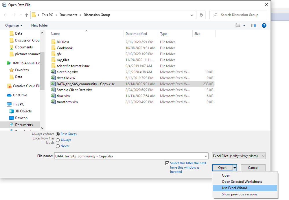

     Specify to use the JMP Excel Wizard to help to open the file
In the JMP Excel Wizard window,
     Specify 3 as the Number of rows with column headers
     Specify 4 as the Data starts on row
     Click on Import

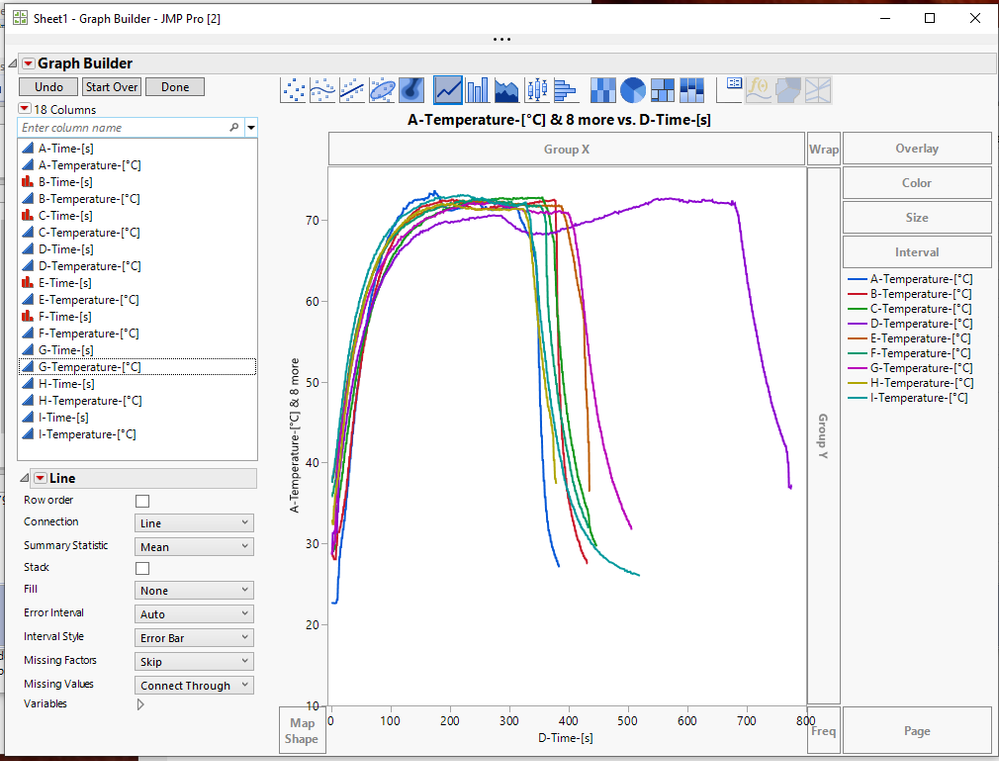

Open the Graph Builder platform by clicking on the Graph Builder Icon on the icon bar at the top of the window
In the Graph Builder window
     Drag the column D-Time to the X axis drop area.  The D-Time column is selected, since it contains all of the values for the Times
     Select all of the Temperature columns, and drag them to the Y axis drop area
     Click on the Line Chart Icon at the top of the window
You will now have a screen that looks like

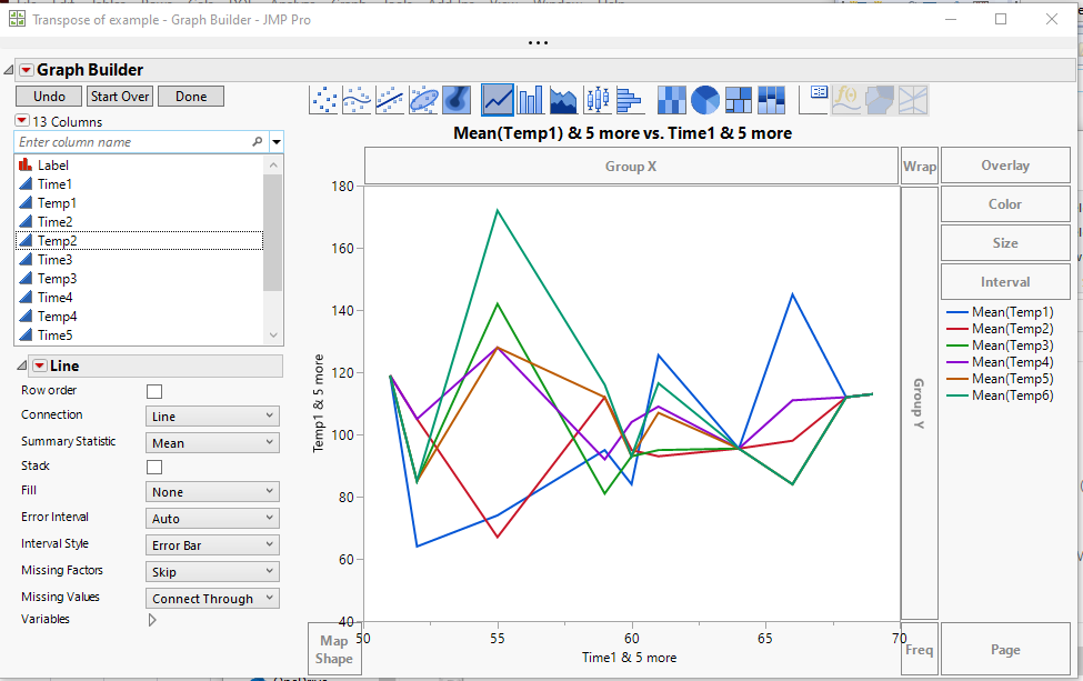

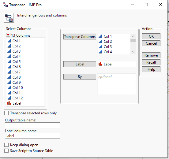

Re: graph Builder with several X lines

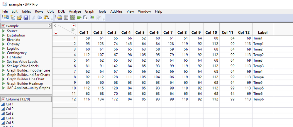

JMP needs for the data to be in a different structure.  Your data looks like
But without the "Label" column.
An easy way to convert your data is to add a Label column, and give it the Values like displayed in the above data table.

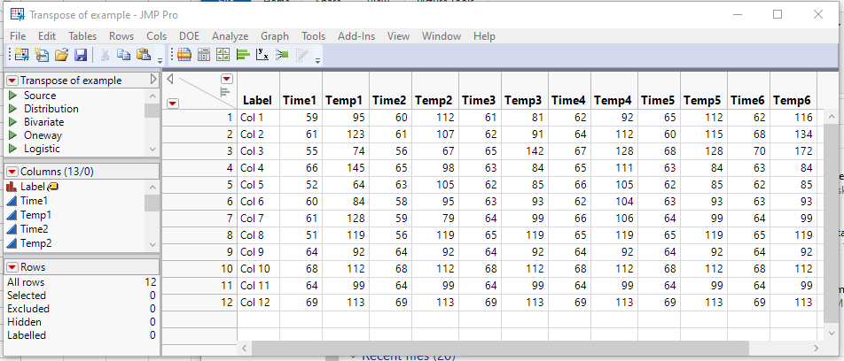

Then go to the Tables pull down menu and select Transpose
     Tables=>Transpose
and specify all of the Col columns as the Transpose Columns, and the Label column as the Label
It will give you a table that looks like
Now you can go to Graph Builder and create the graph by dragging all of the selecting all of the Time columns and dragging them to the X drop area, and then selecting all of the Temp columns and dragging them to the Y drop area and then clicking on the Line Chart icon at the top of the window
Jim

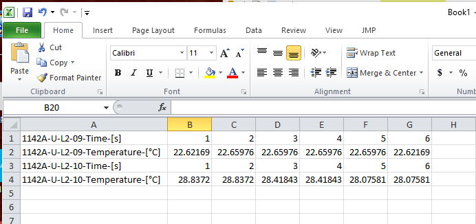

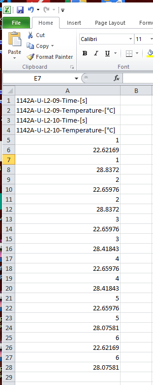

OK, so let's start with the basic format of your Excel table.  From the data provided in your previous response, is this what your Excel table looks like?
or does your Excel table look like this?

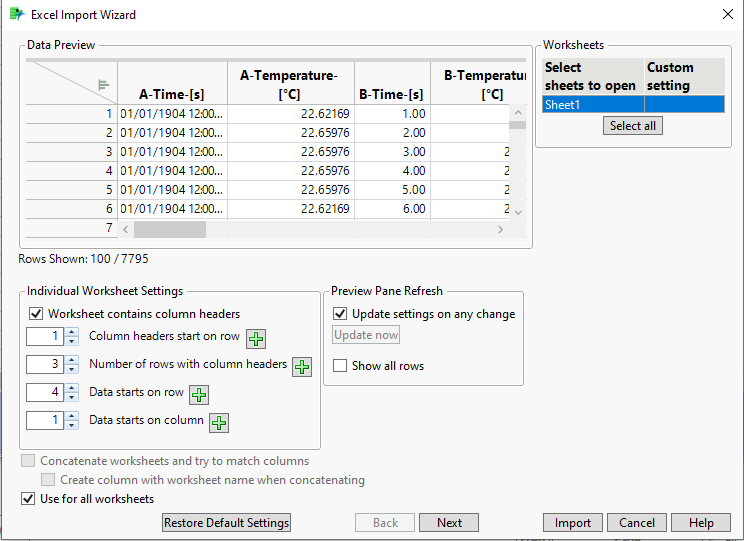

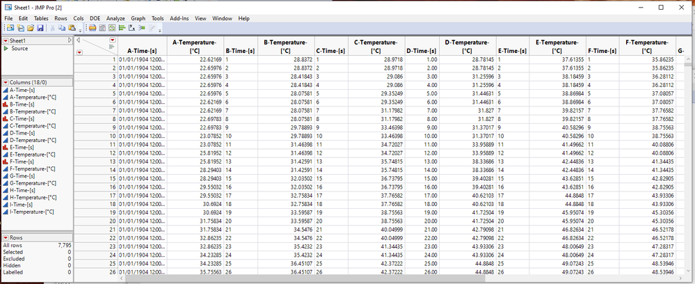

txnelson
Re: HI Re: graph Builder with several X lines
Thank you for the Excel file.  It makes the task an easy one.
Go to
     File=>Open
In the Open dialog box
Navigate to the folder that has the Excel file.
     Select to read in xlsx files
     Click on the Excel file
     Click on Import
The data table will open and it will look like
You need to take the time to read the Discovering JMP and the Essential Graphing documents from the JMP Documentation Library under the Help pull down menu
Jim
