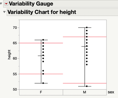

Is this the kind of plot you are after?
If so, for the Variability Chart you will need to use a graphics script. You can make the plot above by running this script:

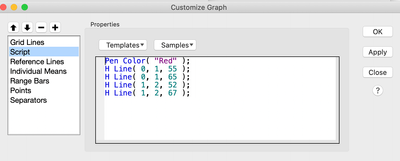

To add horizontal lines by hand, do a right click on the white area of the graph and select 'Customize...'. Then hit the '+' sign to add them using 'HLine()' with the values you need:
You can add such lines as part of a bigger JSL script, and if you need to do this often you may want to look into this.
2 REPLIES 2
alvin
Level I
Re: How to have different reference line by groups in variability charts?
Thanks! That's indeed what I am looking for.
