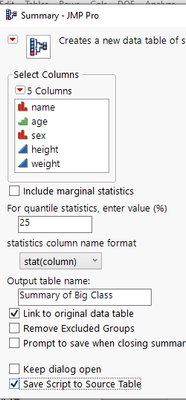

dtsummary = dt << Summary(Group( :height ));
dtsub = dt<< Subset( All rows, Selected columns only( 0 ) );
maintable = dtsummary << get data table(); // doesn't work
maintable = dtsub << get data table(); // doesn't work
so: no?
jthi
Re: get main data table()
For interactive usage you would use Workflow builder (or enhanced log) to make it fairly simple. For scripting, currently, you would have to parse Source Script or Linked Subset table variable (doesn't exist for Summary) if you don't want to utilize references. There should be << Get Original Data Table (should have been added when << Is Linked Subset was added) but currently we don't have one.

Original Data Table is the name which is used in both Summary and Subset platforms as the named parameter is "Link to original data table", so I think it would be nice to have some consistency (main data table could be other option but then all the original data tables should be updated), but we will see.
https://www.jmp.com/support/help/en/18.0/#page/jmp/create-a-subset-data-table.shtml
