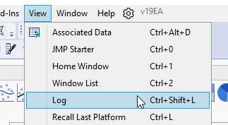

The JMP Log might have an error statement

and then you can go to the Log and check the code ...
