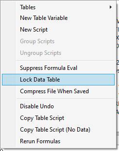

formula not automatically evaluated until clicking apply button
Hello. I made a script adding a column with a conditional formula , the output resulted to a null column only until you click apply in the column formula, I want to automatically output it , I asked colleague to try my data and script , it worked with them. what could be the problem with my jmp16.
new column("Remarks01",character,nominal,formula(If( :Remarsk00 == "Y",
    "1_a",
    "2_b"

Hi,
The automatic formula evaluation might be suppressed in your data table preferences (top left red triangle menu)
Let us know if this does the trick.
Best,
TS

Hi @Thierry_S
thanks for the feedback! seems like it was the problem.
but can you tell when does suppressing usually happens and how to get rid of it?
