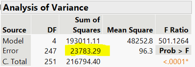

Just to confirm, the SSE is the highlighted value we get from this table here, correct?

Re: How do I calculate partial r-squared on a multivariate regression model
Yes and yes.
