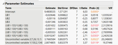

The models in itself are quite correct (depending on the precision of the model you expect), with high R² (0,87) and quite low RMSE (around 0,5). However, as already seen in the Multivariate platform (correlations), some of your factors are linearly dependent of each others, which creates high VIF (around 20 for the two uncontrolled variables) and may result in variance increase in predictions:

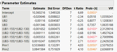

One option to reduce this collinearity could be to create principal components out of these 2 variables (script "3.a. PCA of uncontrolled variables 1&2"), and realize the same type of model as before (but replacing uncontrolled variables 1&2 by their 2 principal components, script "3.b. Fit Model with PCs") :
This won't change the performances of the model in terms of R² and RMSE, but decreasing the VIFs help reduce the variance in parameter estimations (for parameters involved in this collinearity situation).
