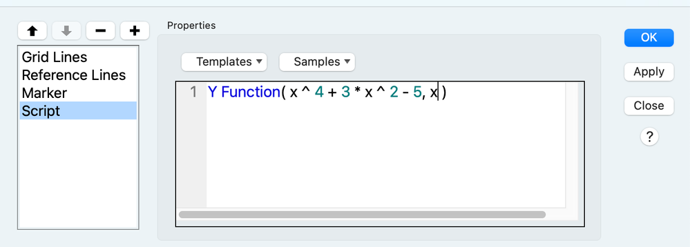

Right-clicking on the graph, select "Customize" from the context menu, click the "+" icon. From here you can add a script using the Y function ( ) function, which takes 2 arguments: an expression (the function) and the domain variable (here, x).
Click OK and you're done.

Your initial suggestion of adding a script via the customize function worked. Thank you!
