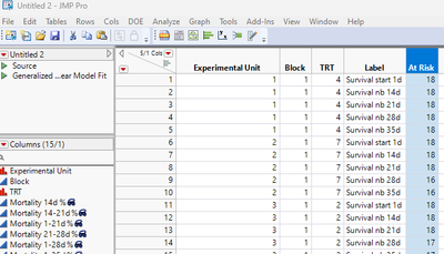

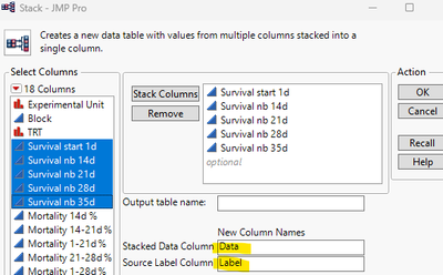

First step: stack these columns. Notice the new column names.
In the resulting table, change the "Data" column name to, say, "At Risk". Here is the resulting table.

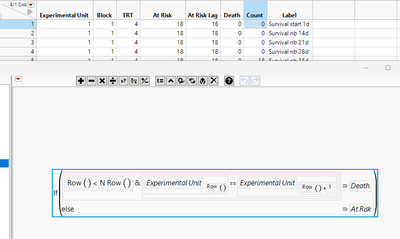

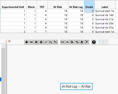

Create a new formula column "At Risk Lag", which records what "previously" in "At Risk":
Create another formula column "Death", which calculates the change in "At Risk" between time points, presumably mortality counts:
Create another formula column "Count", which records mortality counts if the row is not the last one in the Experimental Unit, or records survival counts if the row is the last one in the Experiment Unit:

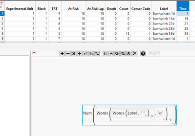

Create another formula column "Censor Code" to indicate whether the corresponding "Count" is death (0) or survival (1).
Now create the last column "Time", which extracts time information from "Label":

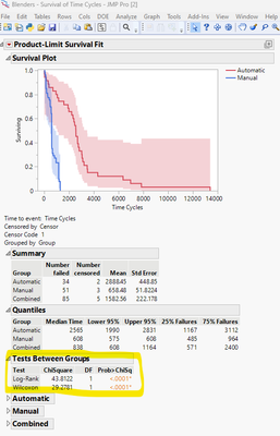

The following is a screenshot taken from Survival analysis report of the Blenders sample data.
There are two tests available, circled in yellow. They emphasize the comparison in different ways. Please check out the following documentation for their explanation:
https://www.jmp.com/support/help/en/18.0/#page/jmp/statistical-details-for-survival-analysis.shtml#
Another way to compare is to turn on confidence intervals in Plot Options. There are two types: pointwise and simultaneous. Use "pointwise" if you want to compare mortality rates at a single time point. Use "simultaneous" if you want to compare rates of a range of time. Depending how much much overlaps, you can get a sense about how much they are different or similar.
