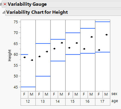

Hello,
I am trying to create variability plots and show spec limits with values specified in LCL and UCL columns. I need different spec values for within graph (based on ROUTE_TYPE column, FL and SL have different limits) and for 2nd variability plot (for OVL_UNL parameter, L2_L1 has different FL/SL limits vs L3_L2)
Thanks
txnelson
Re: different spec limits for different variability plots
To accomplish this you will need to use << Add Graphics Script to the Variability Chart, that reads the LSL and USL values an then adds them as lines to the chart.  The script below is an example
Names Default To Here( 1 );
dt = New Table( "Example",
	Add Rows( 12 ),
	New Column( "age", "Ordinal", Format( "Fixed Dec", 5, 0 ), Set Values( [12, 12, 13, 13, 14, 14, 15, 15, 16, 16, 17, 17] ) ),
	New Column( "sex", Character( 1 ), "Nominal", Set Values( {"F", "M", "F", "M", "F", "M", "F", "M", "F", "M", "F", "M"} ) ),
	New Column( "Height",
		Numeric,
		"Continuous",
		Format( "Fixed Dec", 12, 1 ),
		Set Values( [58.6, 57.3333333333333, 59, 61.25, 62.6, 65.2857142857143, 63, 65.2, 62.5, 68, 62, 69] )
	New Column( "LSL",
		Numeric,
		"Continuous",
		Format( "Best", 12 ),
		Set Values( [45, 45, 50, 50, 57, 57, 60, 60, 60.5, 60.5, 61, 61] )
	New Column( "USL",
		Numeric,
		"Continuous",
		Set Values( [60, 60, 65, 65, 67, 67, 70, 70, 72, 72, 75, 75] )
vc = Variability Chart( Y( :Height ), X( :age, :sex ), Std Dev Chart( 0 ) );
Report( vc )[framebox( 1 )] << add graphics script(
	For( i = 1, i <= N Rows( dt ), i++,
		xstart = (:age[i] - Col Min( :age )) * 2;
		If( :sex[i] == "M",
			xstart = xstart + 1
		Pen Color( blue );
		Pen Size( 2 );
		yMat = Matrix( :LSL[i] || :LSL[i] );
		xMat = Matrix( xstart || xstart + 1 );
		Line( xMat, yMat );
		yMat = Matrix( :USL[i] || :USL[i] );
		Line( xMat, yMat );

txnelson
	Add Rows( 12 ),
		Numeric,
		"Continuous",
	New Column( "LSL",
		Numeric,
		"Continuous",
	New Column( "USL",
		Numeric,
		"Continuous",
		If( :sex[i] == "M",
			xstart = xstart + 1
		Pen Color( blue );
		Pen Size( 2 );
		Line( xMat, yMat );
		Line( xMat, yMat );
Jim
