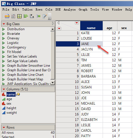

Is it possible to select cells with the cursor and copy the contents of cells to the paste board?
Hello!
Is JMP possible to select cells with the cursor and copy the contents of cells to the paste board?
  • Select cell[3,1],  then "JANE" copy to paste board.

You could try using Row State Handler. Quick example without proper error handling:
Names Default To Here(1);
f = Function({a},
	If(N Items(dt << get selected columns) < 1,
		return();
	Main Menu("Edit:Copy", dt << Get Name);
rs = dt << make row state handler(f);
-Jarmo

Hi,
Does right-clicking on the cell and selecting "Copy" or, alternatively, Ctrl-C do what you want?

It is my ideal, VBA has cell click event code can be implemented.
Private Sub Worksheet_SelectionChange(ByVal Target As Range)

d3 = Current Data Table();
c = (d3 << get selected columns)[1];
r = (d3 << get selected rows)[1];
gm = Column( d3, (d3 << get selected columns)[1] )[(d3 << get selected rows)[1]];
