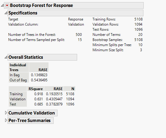

In attached 2 jmp files. The one named Training-validation-test was used to build a RF model with the following results.
The file contains one numeric response and 20 different predictors with one of them categorical, The predictors are sensors values.
As you can see the Bias is very good while the variance is slightly high (92-69=23%).
Then a new database with examples never seen by the model was used to simulate the deployment of algorithm on new data.
With high surprise the result was really poor with a R2 between the predicted and the actual response close to zero. We were not able to understand this behavior. The R2=68% for test data after all doesn't seems to be really bad. So we were expecting to obtain for sure a R2 larger than zero.
Please any help/comment is welcome.

Virtually all of the X variables (with the exception of X12, X13, and X19) are significantly different, on average, between the two sets.  So, my guess would be that the new data is not simply another random sample from the same population, but comes from a different population.  It is not surprising that your model, which fit the original data fairly well, does so poorly on new data, when that new data comes from a different population.
I suppose the question to ask is why it comes from a different population?  Apparently you thought the data was being drawn from the same population (or something close to that).  But must of these variables look so different between the two sets that such an assumption is clearly not correct.
To see the differences, I concatenated the 2 tables and just used Fit Y by X, with Y being all of your X variables and X being the source table created when I concatenated them.

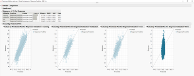

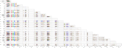

I agree to @dale_lehman , the new data is different.
I was able to fit a similar model, working also poorly on new data.
The Scatterplot matrix showing some details, e.g. X5 using very small range of the original data, same with X11 ...
In both pictures the new data is selected. Maybe this helps you to find the reason why there is a difference.
