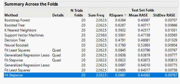

Mybe this can help in the discussion. I used the excellent model screening option in jmp pro by using the nested option to tune hyperparameters combined with the k-fold cross validation. Here the results obtained after some hour.of jmp work
What was surprising me is the large difference among the models in terms of performances. The tree models and KNN showed a R2 above 50% while all the fit models showed values well below the 50% (close to zero) even though the lasso and ridge regularization usage. Mybe is this difference that explain the bad performance of RF/Boosted  models once deployed in production?
What do you think? Any comment/suggestion/help?
