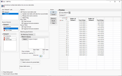

I believe the
     Tables=>Join will do what you want.
Here is a script that creates your 2 sample tables, and then Joins them together and highlights all of the rows with date differences greater than 90.

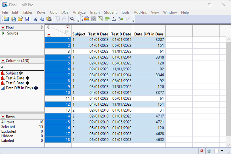

dtFinal << New Column( "Date Diff in Days", formula( Abs( :Test A Date - :Test B Date ) / In Days( 1 ) ) );
dtFinal << select where(:Date Diff in Days > 90 );

I got the same thing as you, except for 2 items:  I calculated the difference in months rather than days (an oversight - days makes more sense), and you used the absolute value of the difference.  That factor is unclear from the request - I would normally think of the tests as sequential (A preceding B), but given that a number of the B tests preceded the A tests, I guess the absolute value makes more sense.

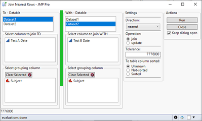

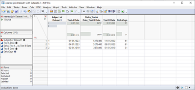

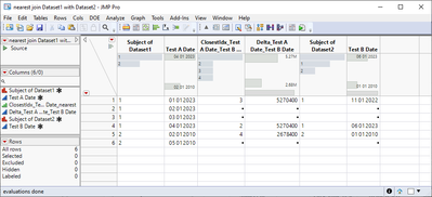

I have also written an add-in which could be used for this (it is clunky to use and automating it might be a bit difficult, but it should be possible). Join Nearest Rows - Join tables by using continuous columns and nearest values . I hope that I have time to rewrite this at some point
Tolerance is set to 7776000 as JMP datetimes are in seconds. Join direction is Nearest as we can join backwards or forwards
and from result you can remove extra rows with no matches
After some cleanup

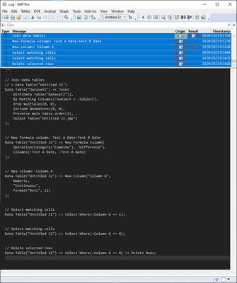

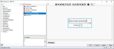

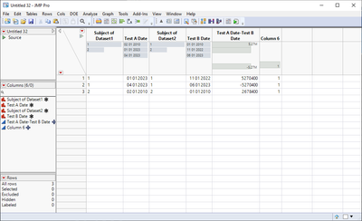

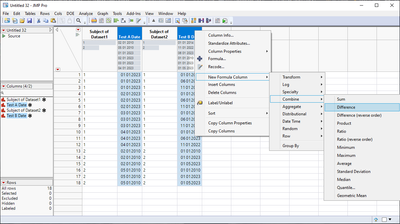

But in this case I think using JMP's interactive solution and taking the script JMP creates for you (join by subject, add new column based on date differences (right click menu can do this), add second column to check if the difference is small enough, perform selection based on that and remove extra rows). Both @txnelson and @dale_lehman did more or less suggest this
Join:
Adding first cormula column

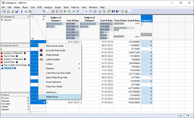

Adding second formula
Select 0 rows and delete those
Final result
JMP created script (this should be cleaned up a bit, good post regarding that  )
