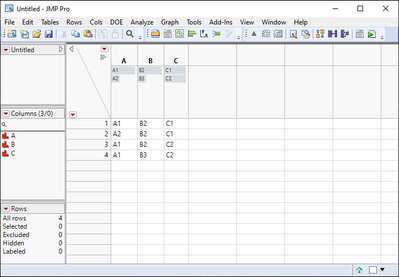

If you had data like this where (COL -> Most appearances) is A -> A1, B -> B2, C -> C1 (in reality C has a tie, how should these be handled?)
Would you wish to only keep row1 as it has A1, B2 and C1? And if there were more rows with the same values, would you want to keep them all? Or are you looking for something totally different, for example do you want to have a table which just has the values which appear the most?
