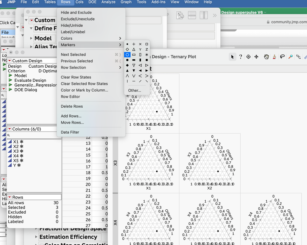

Have you tried using a Ternary Plot (under  Graph Menu) and then selecting the interior point(s) in the design, and then using the Rows > Markers to mark the row(s)?
Re: Does JMP label the centroid in a mixture design?
There is a script in the Sample Scripts folder of JMP called LabelMixturePoints.JSL. This script will identify vertices, edges points,  etc. It will not label a centroid, instead it will state that the point is an Interior point.
