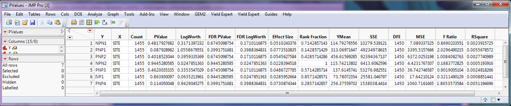

If you go to
     Analyze==>Screening==>Response Screening
You can enter in all of your Y variables, and you X variable(s) and it will generate a data table with your results, including the p-values
Jim

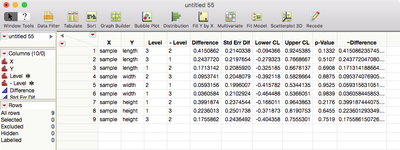

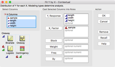

Start with Fit Y by X using sample as X and length, width, height as Y.

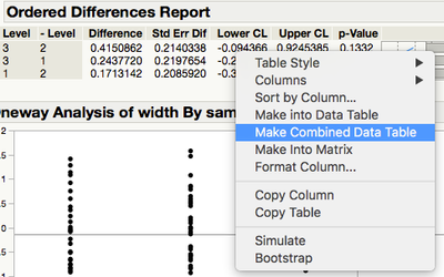

Then, in the report, hold the Ctrl key (Windows) or Command key (Mac) down and choose Compare Means -> All Pairs, Tukey HSD.
Then in the report table that contains the p-Values, right click and choose Make Combined Data Table.
That gets you one data table with all the p-values.
