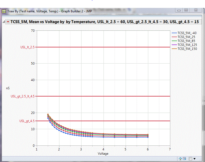

I tried the carat substitution idea too.  I had seen this method referred to but didn't understand it before.  Your code was very helpful with a straight forward implementation into my original code (copy, cut, paste and work!).  The "\[" is something I didn't know about, and I have another problem I can use this evalinsert solution on.
My apologies to all in the manner that my replies are getting added to the thread.  My intent was to address each code poster's reply after theirs but I keep seeing them somewhat randomly added. The reply with the graph picture in it was intended as comment to the 2nd code example.  This post is intended for the 3rd code example, and the others all pertain to the 1st code example.

This was also a segment of a larger function to build a generic graphing function (still a work in progress).  Completed graph looks like this:
