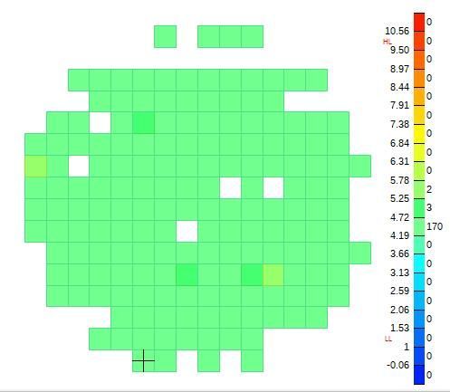

I'm trying to create a plot of column Z by a matrix of X & Y, (X & Y have discrete values, Z is continues).
was only able to create contour plots but I'm trying to get something like this:
does anyone have an Idea?
would love a solution in  a script format....

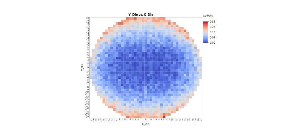

What you are showing would be accomplished with the Heatmap option from Graph Builder.  Please refer to this script for an example:
dt = Open( "$SAMPLE_DATA/Wafer Stacked.jmp" );
dt:X_Die << Set Modeling Type( "Ordinal" );
dt:Y_Die << Set Modeling Type( "Ordinal" );
dt << Graph Builder(
	Size( 554, 521 ),
	Show Control Panel( 0 ),
	Variables( X( :X_Die ), Y( :Y_Die ), Color( :Defects ) ),
	Elements( Heatmap( X, Y, Legend( 4 ) ) )

Got exactly what I wanted!
