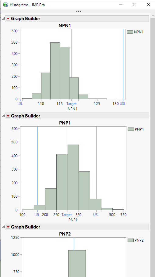

JMP has a built in feature that will automatically display Spec Limits, LSL, Target & USL, on most charts, if the Spec Limits column property for each column is populated.  JMP also has a platform called "Manage Spec Limits" that allows one to take limits from a data table and populate the Spec Limits column property for the various columns in a data table.  The limits are of course saved with the data table when the table is saved to one's hard drive.  So you only have to populate the limits once.  The issue with your data, is that it is not in separate columns.  So to use this method, you will have to use Tables==>Split to separate each product into a separate column.  Easily done.  Then a simple Tables==>Summary grouping by Product, and adding a new column to the resulting data table you will have a limits table that using "Manage Spec Limits" platform will allow you to populate all of the columns in the data table with the limits from the limits table.  Then when you run your Graph Builder, the limits will automatically appear on every histogram.  histo.PNG
I have attached my data table, with an embedded script that produces the histograms, and also a copy of a limits table that can be used as a model for your needs.

Note, that in my case I want to deviate away from the usual column property of "spec limits" that allows me to work with LSL, Target and USL because I have FOUR reference lines of interest. Using the histogram I want to assess the situation vs. these four lines.
I am currently building on your file to script the solution so for each histogram I add four reference lines and make sure the min/max values on the axis are appropriate. This works well but I was wondering if there is a simpler way to manage this using graph builder where I could tweak the Elements e.g. Line and Histogram and use the data filter to switch between product. If so, I would have thought a JSL-free solution could have been forthcoming.
