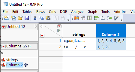

txnelson
Re: How to extract the position of a char in a string?
Expanding on @jthi great solution, I believe the best way to handle your issue is to create a new column to place the results in.  Also, you indicated that not just a "." might be used as a special character.  So the JSL below is a formula that can handle multiple special characters, and also returns the results in a new column.  Just create a character column and cut and past the formula into it.
list_of_chars = Words( :strings, "" );
Substitute Into( list_of_chars, ".", "", "+", "", "/", "" );
charList = As List( Loc Nonmissing( list_of_chars ) );
Substr( Char( charList ), 2, Length( Char( charList ) ) - 2 );
