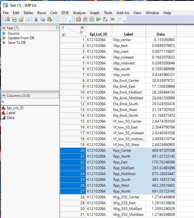

Hello,
I would like to create new tables based on selected rows in "label" column. For example I would like to select rows starting with "Rpp" such as
Rpp_Center
Rpp_North
Rpp_East
Rpp_MidEast
Rpp_MidWest
Rpp_South
Rpp_West
Rpp_North
and create a new table called Rpp. Then, select rows starting with Wig_350
Wig_350_Center
Wig_350_East
Wig_350_MidEast
Wig_350_MidWest
Wig_350_South
Wig_350_West
Wig_350_North
and create a new table called WIG.

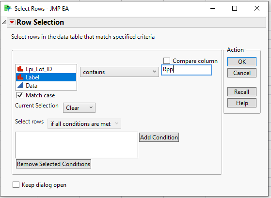

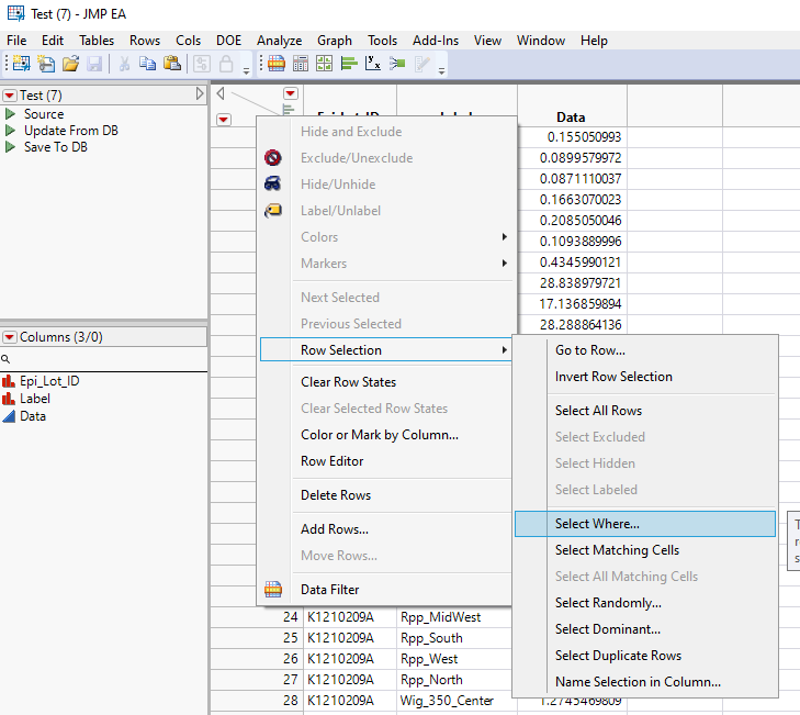

To do this interactively, go to the area at the top of the Row State column(the column that has the row numbers).  Right click and select
       Row Selection+>Select Where
Then in the dialog that is opened, specify to find rows where Label Contains "Rpp"
It will then select the rows you want

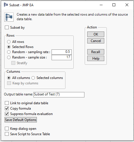

Now go to
     Tables=>Subset

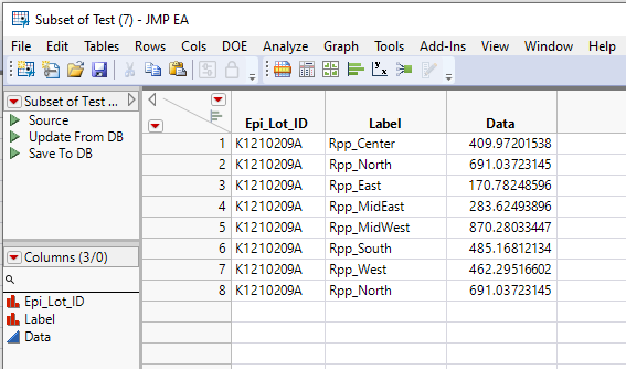

The Subset dialog window will open. Specify to only subset Selected Rows, and all columns
It will then create the new table you want
Repeat the same process for your Wig_350 subset you want.

Names Default To Here( 1 );
dt = Current Data Table();
dt << select where( Contains( :label, "Rpp" ) == 1 );
dt << subset( selected rows( 1 ), selected columns( 0 ) );
