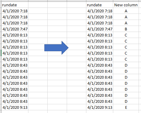

I have a column with date, and want to create a new column,  need assign with {A, B, C, D, E} by judging another column unique date.
Judge by "rundate" cell value(refer to below pic), kindly help on how to generate a script:
1. assign new column Cell[1] == "A", i++, if "rundate" Cell[i] = "rundate" Cell[i++], keep assign new column Cell[i++]=="A".
2. if "rundate" Cell[i] < "rundate" Cell[i++], means date time changed, need assign new column Cell[i++]=="B".
3. if "rundate" Cell[i] = "rundate" Cell[i++], keep assign new column Cell[i++]=="B".
4. if "rundate" Cell[i] < "rundate" Cell[i++], means date time changed again, need assign column Cell[i++]=="C".
rundate
4/1/2020 7:18
4/1/2020 7:18
4/1/2020 7:18
4/1/2020 7:47
4/1/2020 8:13
4/1/2020 8:13
4/1/2020 8:13
4/1/2020 8:13
4/1/2020 8:13
4/1/2020 8:43
4/1/2020 8:43
4/1/2020 8:43
4/1/2020 8:43
4/1/2020 8:43
4/1/2020 8:43
4/1/2020 8:43
4/1/2020 9:13

Hi,
Here is a possible solution that only uses built in functions assuming that your time values are actually coded as times (and not characters)
If( Row() == 1,
	"A",
	If( :Column 1 == Lag( :Column 1, 1 ),
		Lag( :New Column, 1 ),
		Hex To Char( Char( Num( Hex( Lag( :New Column, 1 ) ) ) + 1 ) )
There might be more elegant ways to achieve this but I'm not aware of a function that allows for easy conversion of characters to numerical code and back
Best regards,
TS
Thierry R. Sornasse
Byron_JMP
Staff
Re: create new column with assigned value by another column value
Slightly different approach, and I'm not using letters because there are only 26, and I often have lots more categories.
As long at the value in your :ID (or time) column stays the same, then the counter column stays the same, but when it switches, the counter column goes up by one.
If( Row() == 1,
	1,
	If( :ID == Lag( :ID, 1 ),
		Lag( :counter, 1 ),
		Lag( :counter, 1 ) + 1
These nested If statements can be really handy, or giant monsters, depending on you point of view.
