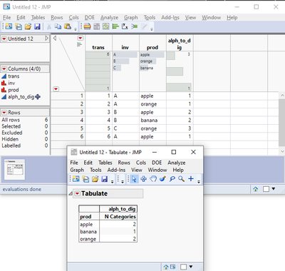

jthi
Re: count unique
It seems like Tabulate platform doesn't behave nicely with Character datatype for analysis. You could change individualID to numeric (recode or create formula to new column) and then use tabulate:
-Jarmo
joann
Level IV
Re: count unique
Thank you! This is good and quick way as well!
