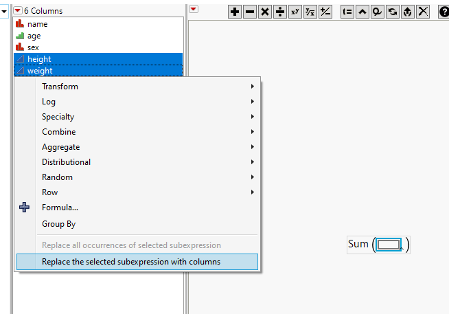

At least on windows you can right click on the selected columns and select "Replace the selected subexpresssion with columns" (make sure the correct "square" is selected in the formula).

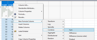

You can also select your columns from the table, right click on one of the column headers and add formula column
