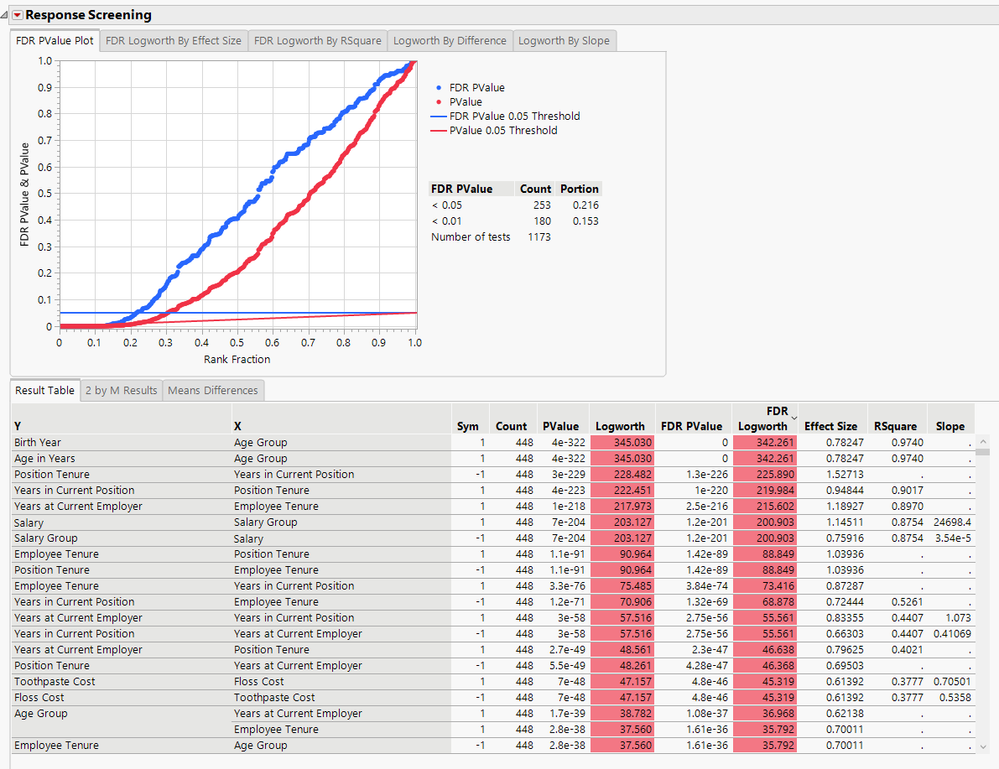

The Response Screening platform is really great at analyzing correlations between large numbers of factors, and it can compare lots of different data types. A good trick is to put all your columns in both the X and the Y role during the launch.

Thanks for the quick reply and for the suggestion. I have to go deep in the response screening since I am not familiar with that.
