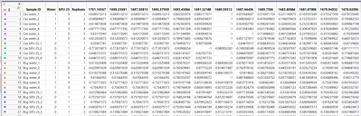

I'm reaching out to see if someone can guide me through the basic steps for performing PLS-DA.
Below is an example of the raw data table I'm using in order to construct the classification method. I'm working with spectral FTIR data, and my objective with the classification method is to see if I can classify samples according to the treatment they have received.
When I proceed with the model, I invariably get that 0 factors are the minimizing number of factors, and hence I cannot classify anything.
I thought this is puzzling, since I've already performed curve fitting analysis of the spectra in question, and with that analysis, there are clear differences between the samples treated and those untreated. Furthermore, I've graphed the treated and untreated spectra and there are clear visual differences... hence, I suspect that I'm doing something wrong.

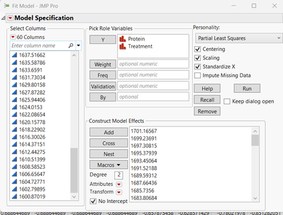

Re: Spectral data + PLS-DA
Hi @Mariana_Aguilar,
I've had a look at the data, and I think that the binary approach of just looking at the treatment is one of the reasons that your modelling approaches are struggle, when I look with FDE (Unconstrained MCR) and PLS-DA and there is a significant effect from the treatment and the protein type used to the spectra - if you are only relating to treatment the model is not going to be able to land on a suitable model as you're missing half of the story.

I'll continue to explore my dataset as you've suggested. If you don't mind my asking... would it be possible to share with me the data Script you've used? I just want to make sure I'm following the appropriate steps in the model specification (image 1).

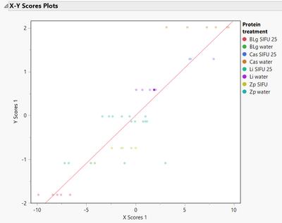

And one last question if I may. Once I've arrived to the score plot (as in the image 2), do you have any suggestion on how can I include eclipses to show groupings? I can only think of K means but I don't know if it's a bit redundant after PLS-DA.
Hi @Mariana_Aguilar ,
Sure, find the file attached. You could try and do the groupings from the Score values (in Save Columns > Save Scores) and take those scores to try and group together - I've made a simple example with Graph Builder (scripted on the table) and you could explore some of the clustering methods available in Analyze>Clustering to see if you can get meaningful grouping. It's also worth having a play with the settings in the PLS method for centering, scaling and Standardize X, as changes to these can improve the model fit (as well as removing non-important VIP variables and re-running the model).
