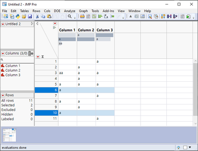

cols_to_check = {"Column 2", "Column 3"};
m = Matrix(IsMissing(dt[0, cols_to_check]));
rows_to_delete = Loc(V Sum(m`) == 2);
dt << select rows(rows_to_delete); // for demo purposes
dt << Delete Rows(rows_to_delete); // use this in real use case

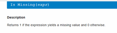

is missing (list) and is missing (matrix)
nice! - and unexpected.
is there a general overview which JSL functions can be "vectorized"?
