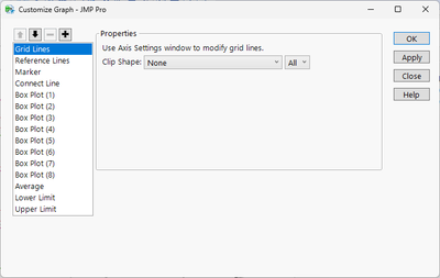

bonjour,
comment faire pour augmenter la taille des traits de la moyenne et/ ou des box-plots à l'aide du script.
peut-on changer la couleur des points et des traits?
cordialement
jthi
Re: control chart
Right click > Customize
will let you change some settings easily and some take a bit more effort as they are all separate items (boxplots)
Some customizations can be possibly "saved" using Presets and you can also create script to do your customizations
-Jarmo

jthi
Re: control chart
-Jarmo

Re: control chart
bonjour,
merci beaucoup jthi.
j'utilise la fonction personnaliser et je sauvegarde le script.
cordialement
hogi
Level XIII
Re: control chart
If editing dozens of Box plots is no fun for you,
you can access the FrameBox via JSL scripting -  and then talk to the Marker and BoxPlotSegs:
fb1 = current Report()[Framebox(1)];
markerseg = fb1 << find seg("MarkerSeg");
markerseg << set marker size(10);
// talks to ALL Box plot: boxSegs = fb1 << find Segs("BoxPlotSeg"); boxSegs << set line width (3)
