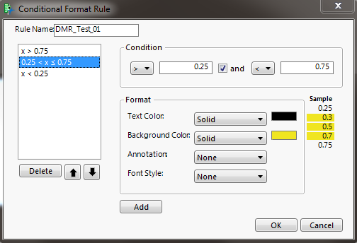

This is a bit late for a reply to your original query, but I found myself in a very similar situation to the one you describe a couple of days ago - and this is what I did to get the effect I wanted:
First, use the interactive dialog as described in https://community.jmp.com/t5/Discussions/Is-there-a-way-to-send-a-font-color-to-a-single-value-in-a/... to create the set of conditions you want. What I wanted to do was to shade the cells of all the NumberColBoxes in a TableBox with a background color of red if the contents was less than 0.25, amber if it was greater than or equal to 0.25 but less than 0.75, and green if it was greater than or equal to 0.75.
I wanted the text color changed from black to white when the background color was red or green to make it easier to read, and I could also have also applied bold and/or italic options to the text if I'd wanted to. The dialog screen when looking at the "amber" condition looked like this:
Having set it up, I then needed to see what the above looked like in JSL so I could incorporate it into my script. To do that, type "show preferences()" into a script window and run it. The output shows all your preferences, including the one that's just been set up, which in my case looked like this:

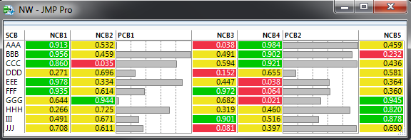

I can now see from the Preferences how to get the correct syntax for (a) specifying a range, (b) changing the background color of a cell and (c) incorporating a "greater than or equal to" condition.  Running the above script should produce something like this:
I hope this might be of help to anyone trying to do something similar.
