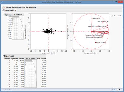

how to decide the number of variables to use after principal component analysis? I have the following result :
On basis of what parameters should I select principal components?

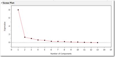

One school of thought says to looks at the Scree Plot.
The Scree Plot is the Eigenvalue vs. the Number of Components in the PCA.  Retain the components in the portion of the steep curve, before the first point that starts the flat line trend.  In these Body Fat data, this school of thought could suggest that you retain one component.
Scree Plots are often no-so-easy to interpret.  One school of thought says to use your knowledge about the parameters to make a decision about the components to retain.

I agree that the seemingly-easy question is never quite so easy as one might think. Kevin points you in the right direction in terms of components.  PCA reduces your large number of variables into a small number of components, looks like 1 (2 at most) is all you need.
