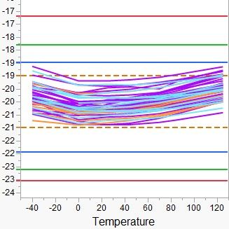

Hi, Is there a way to refresh a graph builder axis using jsl?  The last line in my code (...<max()<<min();// ) is resulting in multiple values on an axis, see vertical axis in attached picture.
I use the setwidth(0) on distribution for cases where I end up needing to reset the axis width based on number of digits. setwidth(0) sets it automatically. i'm not sure how much it helps on graph builder.
I'm hoping there's an automatic way to adjust it, otherwise I can play with minor ticks and inc().
My code does something like this but I haven't been able to distill my code/tables down to a shareable and reproducible version.

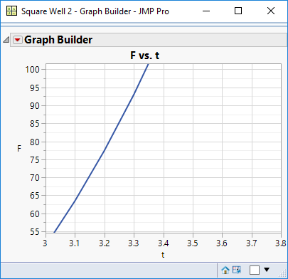

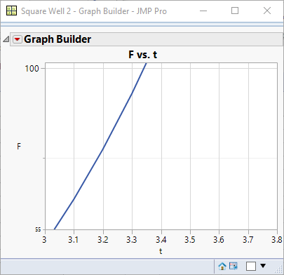

For what it is worth, below is some code that reproduces the problem.  Well, in spirit.  When the code runs it creates a strange looking y-axis:
Not the same problem that you have but a formatting problem nontheless, and one that is probably fixed in the same way that you are asking for:
use the grabber tool to give it a tiny nudge (this is what I think you mean by 'refresh'):
Here is the code that reproduces the above output (sorry for ther embedded table).  Different code, but I kept your last line :)

gbObj = Graph Builder(
	Size( 382, 300 ),
	Show Control Panel( 0 ),
	Variables( X( :t ), Y( :F ) ),
	Elements( Line( X, Y, Legend( 9 ) ) ),
	SendToReport(
		Dispatch(
			"t",
			ScaleBox,
			{Format( "Best", 12 ), Min( 3 ), Max( 3.8 ), Inc( 0.1 ),
			Minor Ticks( 0 ), Label Row( Show Major Grid( 1 ) )}
		Dispatch(
			"F",
			ScaleBox,
			{Min( 50 ), Max( 200 ), Inc( 50 ), Minor Ticks( 1 ),
			Label Row( {Show Major Grid( 1 ), Show Minor Grid( 1 )} )}
		Dispatch( {}, "Graph Builder", FrameBox, {Marker Size( 0 )} ),
		Dispatch(
			"400",
			LegendBox,
			{Legend Position( {9, [-1]} ), Position( {-1} )}
// first time i have seen xpath used to traverse the display tree :)
gbOlbXpObj = gbObj << xpath( "//OutlineBox[ text() = 'Graph Builder']//AxisBox");
gbOlbXpObj[2] <<  max(101.6589)<<  min(55) << setwidth(0);// << inc(myInc);
-Dave
