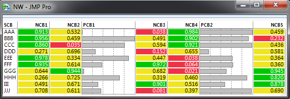

I can now see from the Preferences how to get the correct syntax for (a) specifying a range, (b) changing the background color of a cell and (c) incorporating a "greater than or equal to" condition.  Running the above script should produce something like this:
