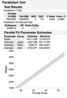

After some digging...the ANOM in the nonlinear platform appears to be comparing the estimates to the "parallel" model where the model for each group has the same shape but is shifted along the x-axis.  So in the case of the example we have been looking at the center line for the slope ANOM of 144.71 is the slope of the model with the same slope but different intercepts for each group.
Re: comparison of slopes
I think this kind of analysis (parallel slopes) is consistent with a 'proper' ANCOVA. Julian talks about that in one of her videos here:
https://youtu.be/k3zk45WrmUI?t=1400

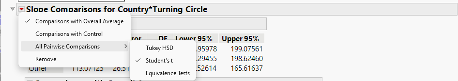

In recent JMP versions, the Fit Model Platform also has a "Compare Slopes" report option under Estimates under the top red triangle in the Fit Model output.
This report can be used to statistically compare each of the individual slopes (corresponding to each Level of the categorical factor) to the overall average slope, using the Analysis of Means (ANOM) construct in JMP.

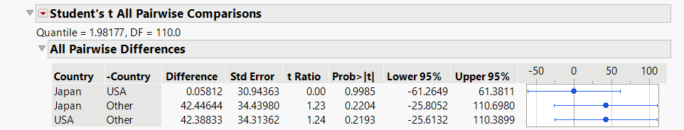

For example, when comparing Japan to USA, we can assert that we do not have evidence to reject the null hypothesis that the slopes are the same, given the Pairwise comparisons test p-value obtained = 0.9985.  We can make similar statements when comparing Other vs USA, and Japan vs Other (where p= 0.2193 and p=0.2204, respectively).

As part of the JMP 19 release cycle, the Compare Slopes report has been updated to include the ability to compare slopes directly in a student's t or 'multiple comparisons corrected' (e.g. Tukey HSD) framework:
As we can see here, the results presented using the Student's t submenu option (in the JMP 19 EA 5 release, current as of the time of this writing) match what was originally summarized using the method that @julian patiently walked through in the original solution to this post.
